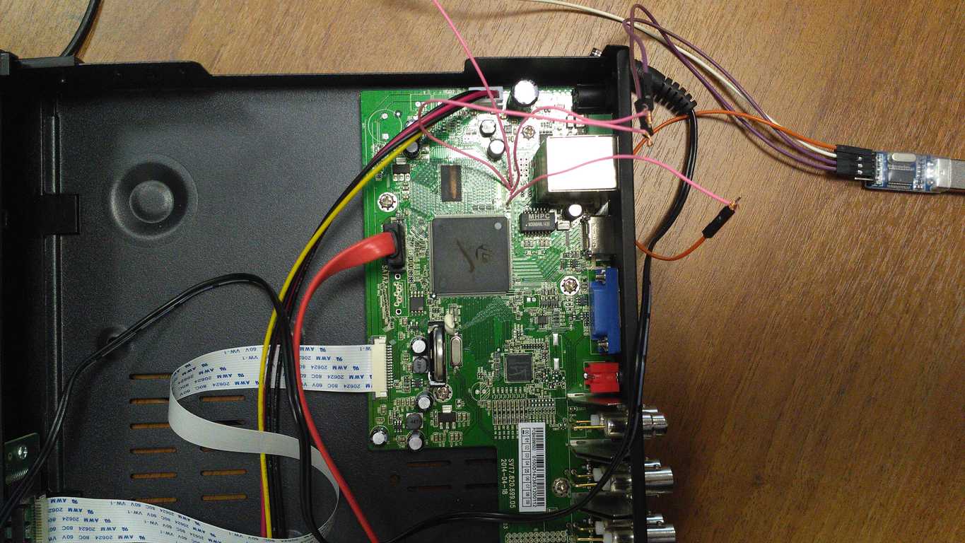

Доброго времени суток! После неудачной прошивки видеорегистратора Safari SVR-4L пропала загрузка. Прошу помочь с восстановлением.
  • U-Boot 2010.06 (Dec 20 2013 - 11:18:51)
    U_BOOT:7104XC_VA UBOOT T20131220 11:18:42
    main_board_ver 0x0
    DRAM: 256 MiB
    Check spi flash controller v350... Found
    Spi(cs1) ID: 0xC2 0x20 0x18 0xC2 0x20 0x18
    Get match MX25L128XX 0x3C 0x0
    Spi(cs1): Block:64KB Chip:16MB Name:"MX25L128XX"
    *** Warning - bad CRC, using default environment

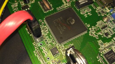

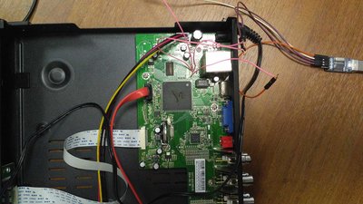

    [DeviceManageSystemConfig.cpp][Dm_init_main_board_ver: 00002184]Main board Version: 0x0
    DriverHi35xxGpio Version[HI3515A]:2013-06-17 05:31:54
    [main.cpp][Signal_handle: 00000018]Signal_handle Children Process Exit: 0
    [DeviceGpioI2c.cpp][Gpioi2c_init: 00000170]pCmd_line /sbin/insmod /module/extdrv/DriverGpioI2c.ko gpioi2c_bus_num=1 gpioi2c_scl1_group=1 gpioi2c_scl1_bit=7 gpioi2c_sda1_group=1 gpioi2c_sda1_bit=6
    DriverGpioI2c Version[HI3515A]:2013-06-17 05:32:02
    Gpioi2c_init config(bus_num:1):
    Gpio i2c bus(0):[SCL:GPIO1_7][SDA:GPIO1_6]
    [DeviceManage.cpp][Dm_init: 00004124]CDeviceManage::Dm_init NOT SUPPORT HARDWARE I2C
    [DeviceManage.cpp][Dm_init: 00004135]CDeviceManage::Dm_init NOT SUPPORT At88sc0104
    DriverCx2682x Version[HI3515A]:2014-01-10 16:25:38(chip_num:1)
    Cx2682x_module_init (dev_addr:0x88)(rev_id:0xffff)
    Kernel panic - not syncing: Fail to realize chip id 0xFFFF
    Backtrace:
    [<c002e8d4>] (dump_backtrace+0x0/0x110) from [<c028d4d0>] (dump_stack+0x18/0x1c)
    r6:bf9ddf44 r5:00000000 r4:c036ff90 r3:c03562d4
    [<c028d4b8>] (dump_stack+0x0/0x1c) from [<c028d530>] (panic+0x5c/0x17c)
    [<c028d4d4>] (panic+0x0/0x17c) from [<bf9e11cc>] (Cx2682x_module_init+0x1cc/0x398 [DriverCx2682x])
    r3:00006824 r2:c03562f0 r1:0000ffff r0:bf9dda38
    r7:00000000
    [<bf9e1000>] (Cx2682x_module_init+0x0/0x398 [DriverCx2682x]) from [<c00253b4>] (do_one_initcall+0xa0/0x170)
    r6:00000000 r5:bf9e1000 r4:bf9ddfe4
    [<c0025314>] (do_one_initcall+0x0/0x170) from [<c006397c>] (sys_init_module+0x7c/0x198)
    r9:c44a6000 r8:c002b1c8 r7:0000e47f r6:00000000 r5:016c1060
    r4:bf9ddfe4
    [<c0063900>] (sys_init_module+0x0/0x198) from [<c002b020>] (ret_fast_syscall+0x0/0x30)
    r7:00000080 r6:be9a2d24 r5:00000069 r4:be9a29b4
