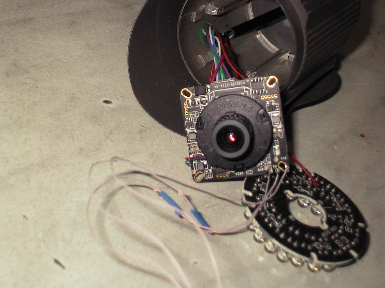

Помогите восстановить HI3518E+OV9712

Уважаемые форумчане.У меня то-же на такой же плате подпортилась прошивка из-за некачественного питания.Камера не видится в сети.Сканеры не находят её.Я через UART на FTP сервер слил с неё бинарный файл.Тем же путем получил лог загрузки.Может кто-то по логу поймет что подпорчено и подскажет как исправить.U-Boot 2010.06 (May 19 2014 - 14:51:10)

[01-01-08:00:12][TRACE][main] dev_tty.c:65 [DMS_DEV_TTY_Open] [01-01-08:00:12][TRACE][main] TTY open /dev/ttyAMA3 failed:No such device or address
[01-01-08:00:12][TRACE][main] TTTTTTTTTTTTTTTTTTTTTTTTTT basic_tty.c, 120
[01-01-08:00:12][WARNING][main] ##jiabo video: +++++++++++++++++++++++++++++++++ open rs232 fail
[01-01-08:00:12][TRACE][main] open /dev/hi_i2c(m_i2cfd=5) success!
[01-01-08:00:12][TRACE][main] open /dev/hi_gpio(m_gpiofd=6) success!
[01-01-08:00:12][ERR][main] can't open mt9d131
[01-01-08:00:12][ERR][main] can't open ov10630
[01-01-08:00:12][ERR][main] can't open ip2986
[01-01-08:00:12][ERR][main] DMS_TW9910_VAD_Open Failed!
[01-01-08:00:12][ERR][main] can't open xf_ov2715
[01-01-08:00:12][ERR][main] can't open nvp2400
[01-01-08:00:12][TRACE][main] Check OV9712-iRet = 0,value = 0x9711!
[01-01-08:00:12][TRACE][main] DMS_vadc_hi3518_Open: szBuffer = sensortype=ovb9712,m_nHi3518VIChip = 30!
[01-01-08:00:12][TRACE][main] DMS_vadc_hi3518_Open-318: s32Ret=0x00000000,u32ChipId=0x3518E100!
[01-01-08:00:12][TRACE][main] :::::::::::::::::: VICHIP HI3518 OV9712B
[01-01-08:00:12][ERR][main] DMS_TW2866_VAD_Open Failed!
[01-01-08:00:12][TRACE][main] :::::::::::::::::: AICHIP JB_TLV320
[01-01-08:00:12][TRACE][main] nChannelNum [1], nKeyCheckRes [0]
[01-01-08:00:12][TRACE][main] end of free..
[01-01-08:00:12][TRACE][main] globelMalloc ChannelCount:1
[01-01-08:00:12][TRACE][main] end of malloc..
#### dms_read_protect_key_information_config 1983
[01-01-08:00:12][ERR][main] InitDefaultConfigFile: File(/jb_config/jb_rootfs/jb_default.config) is exist!
[01-01-08:00:12][TRACE][main] +++++++++==========++++++ g_fatal_param.default_flag = 181
[01-01-08:00:12][TRACE][main] +++++++++==========+++++ g_fatal_param.fatal_param_len = 12
[01-01-08:00:12][TRACE][main] [3]: initialize the system parameter with value.
#### dms_read_device_config 363
#### dms_read_device_config 373,cfgbuf:{
"DeviceName": "IPCAM",
"DeviceID": 0,
"RecordLen": 5,
"Language": 1,
"RecycleRecord": 1,
"OverWritePeriod": 0,
"VideoStandard": 0,
"DateFormat": 1,
"DateSprtr": 1,
"TimeFmt": 0,
"ConfigWizard": 0,
"SoftwareVersion": 67116582,
"SoftwareBuildDate": 538120468,
"DspSoftwareVersion": 0,
"DspSoftwareBuildDate": 0,
"PanelVersion": 0,
"PanelSoftwareBuildDate": 0,
"HardwareVersion": 67116582,
"HardwareBuildDate": 0,
"WebVersion": 0,
"WebBuildDate": 0,
"SerialNumber": "JBNV▒/▒T▒▒",
"ServerCPUType": 3518,
"SysFlags": 25559049,
"ServerType": 100004,
"VideoInNum": 1,
"AudioInNum": 1,
"AlarmInNum": 1,
"AlarmOutNum": 1,
"DiskNum": 0,
"RS232Num": 0,
"RS485Num": 0,
"NetworkPortNum": 0,
"DecordChans": 0,
"VGANum": 0,
"USBNum": 0,
"DiskCtrlNum": 0,
"AuxOutNum": 0,
"StreamNum": 0
#### dms_read_device_config 431
#### dms_read_server_user 488
#### dms_read_server_user 500
#### dms_read_server_user 590, i=0, stUserInfo.dwUserRight=-2147483633
#### dms_read_server_user 590, i=1, stUserInfo.dwUserRight=0
#### dms_read_server_user 590, i=2, stUserInfo.dwUserRight=0
#### dms_read_server_user 590, i=3, stUserInfo.dwUserRight=0
#### dms_read_server_user 590, i=4, stUserInfo.dwUserRight=0
#### dms_read_server_user 590, i=5, stUserInfo.dwUserRight=0
#### dms_read_server_user 590, i=6, stUserInfo.dwUserRight=0
#### dms_read_server_user 590, i=7, stUserInfo.dwUserRight=0
#### dms_read_server_user 590, i=8, stUserInfo.dwUserRight=0
#### dms_read_server_user 590, i=9, stUserInfo.dwUserRight=0
#### dms_read_stream_info 625
#### dms_read_record_setting 762
#### dms_read_record_mode_param 853
#### dms_read_channel_cb_detection_config 2788
#### dms_read_channel_pic_param 2233
#### dms_read_channel_color 949
#### dms_read_channel_enhanced_color 1001
#### dms_read_channel_shelter 1067
#### dms_read_channel_motion_detect 1128
#### dms_read_channel_probe_alarm 1251
#### dms_read_channel_probe_alarm 1366
#### dms_read_Channel_AlarmOut 689
#### dms_read_channel_video_lost 1373
#### dms_read_channel_osd_info 1489
#### dms_read_exception_info 1579
#### dms_read_server_cominfo 1665
#### dms_read_server_com2info 1729
#### dms_read_default_ptz_Protocol 2063
#### dms_read_ftpupdata_param 1791
#### dms_read_record_upload 911
#### dms_read_notify_servers 1841
#### dms_read_pppoe_config 1882
#### dms_read_timezone_config 2382
#### dms_read_ddns_config 1930
#### dms_read_producer_setting_config 2021
#### dms_read_upnp_param 2448
[01-01-08:00:12][ERR][main] ____________Application will exit by signal:11,pid:768
[01-01-08:00:12][ERR][main] ____________Application exit thread name main

ln: /usr/lib/libnetpt.so: File exists
read log config ok
[RCS]: /etc/init.d/S80network
(none) login: [01-01-08:00:12][TRACE][JB_HI3511_DVS.o] SYSTEMLOG Init
[01-01-08:00:12][TRACE][JB_HI3511_DVS.o] ========== HI3518 PLATFORM APP V4 Build:Dec 4 2014 15:24:02 pid:768 ==============
[01-01-08:00:12][TRACE][JB_HI3511_DVS.o] MIAN APP Build:Dec 4 2014 15:24:02
[01-01-08:00:12][TRACE][main] ========== HI3518 PLATFORM BAICMODULE Build:Dec 4 2014 15:23:08 ==============
#### I2C_24C04_Write_Data, nPart=0, nPos=120, nSizeSet=2
#### I2C_24C04_Write_Data, nPart=0, nPos=122, nSizeSet=2
#### I2C_24C04_Write_Data, nPart=0, nPos=124, nSizeSet=2
#### I2C_24C04_Write_Data, nPart=0, nPos=126, nSizeSet=2
#### I2C_24C04_Read_Data, nPart=0, nPos=120, nSizeGet=8
[01-01-08:00:12][TRACE][main] [0].g_authen_ic_raw_information.bSize [64]
[01-01-08:00:12][TRACE][main] [1].g_authen_ic_raw_information.bChannelCount [0x1]
[01-01-08:00:12][TRACE][main] [2].g_authen_ic_raw_information.wCompany [6]
[01-01-08:00:12][TRACE][main] [3].g_authen_ic_raw_information.wCpuType [19]
[01-01-08:00:12][TRACE][main] [4].g_authen_ic_raw_information.bAlarmInCount [1]
[01-01-08:00:12][TRACE][main] [5].g_authen_ic_raw_information.bAlarmOutCount [1]
[01-01-08:00:12][TRACE][main] [6].g_authen_ic_raw_information.dwSupOption [0]
[01-01-08:00:12][TRACE][main] [7].MAC [0x0:0x18:0xa9:0x73:0x83:0xc6]
[01-01-08:00:12][TRACE][main] [8].g_authen_ic_raw_information.bSerial [JBNV▒/▒T▒▒]
[01-01-08:00:12][TRACE][main] [9].g_authen_ic_raw_information.bImageSize [3]
[01-01-08:00:12][TRACE][main] [10].g_authen_ic_raw_information.byPCBType [0]
[01-01-08:00:12][TRACE][main] [11].g_authen_ic_raw_information.byPCBVer [2]
[01-01-08:00:12][TRACE][main] At88sc0104 check_encrypt suc .............................................
[01-01-08:00:12][TRACE][main] [jiabo video][APP]: chek encrypt chip ok!
[01-01-08:00:12][TRACE][main] TTTTTTTTTTTTTTTTTTTTTTTTTT basic_tty.c, 78
[01-01-08:00:12][TRACE][main] ##jiabo video: +++++++++++++++++++++++++++++++++ open rs485 ok
"DeviceID": 0,
"RecordLen": 5,
"Language": 1,
"RecycleRecord": 1,
"VideoStandard": 0,
"DateFormat": 1,
"DateSprtr": 1,
"TimeFmt": 0,
"ConfigWizard": 0,
"PanelVersion": 0,
"WebVersion": 0,
"WebBuildDate": 0,
"VideoInNum": 1,
"AudioInNum": 1,
"AlarmInNum": 1,
"AlarmOutNum": 1,
"DiskNum": 0,
"RS232Num": 0,
"RS485Num": 0,
"DecordChans": 0,
"VGANum": 0,
"USBNum": 0,
"DiskCtrlNum": 0,
"AuxOutNum": 0,
"StreamNum": 0
reset
Password:
NAND: Special Nand id table Version 1.35
Nand ID: 0x00 0x00 0x00 0x00 0x00 0x00 0x00 0x00
No NAND device found!!!
0 MiB
Spi(cs1): Block:64KB Chip:16MB Name:"W25Q128B"
In: serial
Out: serial
Err: serial
UpgradeSoftware:8346B000 V1.2
CheckUpgrade invalid maigc(0xc6c63aba, 0xaa5555aa)
hisilicon # help
? - alias for 'help'
cmp - memory compare
cp - memory copy
crc32 - checksum calculation
ext2load- load binary file from a Ext2 filesystem
ext2ls - list files in a directory (default /)
md - memory display
mii - MII utility commands
mw - memory write (fill)
nand - NAND sub-system
nboot - boot from NAND device
sf - SPI flash sub-system
tftp - tftp - download or upload image via network using TFTP protocol
usb - USB sub-system
usbboot - boot from USB device
hisilicon # printenv
bootdelay=1
baudrate=115200
ethaddr=00:00:23:34:45:66
netmask=255.255.255.0
bootfile="uImage"
ipaddr=192.168.1.9
serverip=192.168.1.7
bootcmd=sf probe 0;sf read 0x82000000 0x100000 0x300000;bootm 0x82000000
bootargs=mem=40M console=ttyAMA0,115200 root=/dev/mtdblock2 rootfstype=jffs2 mtdparts=hi_sfc:1M(boot),3M(kernel),11776K(rootfs),512K(config)
stdin=serial
stdout=serial
stderr=serial
verify=n
ver=U-Boot 2010.06 (May 19 2014 - 14:51:10)
Environment size: 442/262140 bytes
hisilicon #
