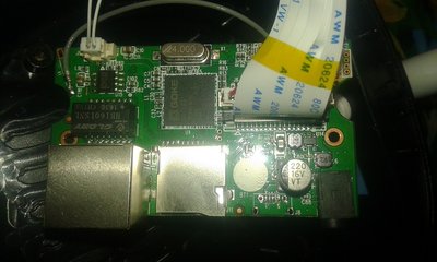

Hello great community. Please help me!!!
I think my cam is bricked. Unfortunately my cam is a chinese unbranded. I can not connect to it by lan or wifi. SD card recovery not work, not detect card. Only way to connect to her is through the serial.
If you can help me or everyone with a DUMP.bin, MTD partitions, zImage or especially mtdblock1. Thanks in advance. Picture with motherboard is in attachment.
This is the serial log:

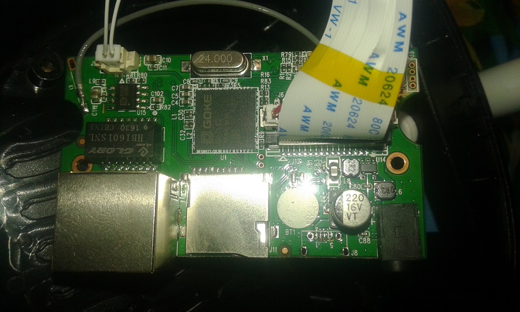

show the dump and recovery file...is there a firmware for this camera?
dede
Сообщения: 1957
Откуда: Луганск
Re: Help unbrick noname IP камерой на SoC GOKE GK7102
Сообщение dede » 09 авг 2018, 22:41
Also, check this recent topic http://videon.spb.ru/forum/viewtopic.php?f=24&t=12240" onclick="window.open(this.href);return false; . There are even some dumps there, which you could either flash, or take needed partitions from there.
sensegsm
Сообщения: 13
Зарегистрирован: 09 авг 2018, 22:00
Откуда: Romania
Сообщение sensegsm » 09 авг 2018, 22:48
Thank for rapid answer. This is dump file: https://www.dropbox.com/s/jt6fqqt7to7l4 ... 2.BIN?dl=0" onclick="window.open(this.href);return false; I have only first 8MB from dump. I do not know which is the original firmware because is a chinese unbranded camera. :(
Ip camera looks like in attachment.
sensegsm
Сообщения: 13
Откуда: Romania
Сообщение sensegsm » 09 авг 2018, 22:56
I try dump from this post:
igoryaremchuk85 писал(а):вот дамп https://yadi.sk/d/RroZmMfV3XBRkV
Result
:cry:

[   16.180000] Endpoint(84) is for Data-In
[   16.180000] Endpoint(85) is for Command Rsp
[   16.200000] usbcore: registered new interface driver rtusbSTA
[   16.230000] encript driver init successful!
[   16.250000] gpio driver init successful!
[   16.310000] i2c i2c.0: i2c[60]:gk7101_i2c_irq in wrong state[0x9]
[   17.310000] i2c i2c.0: I2C state 0x10, please check address 0x20!
[   17.310000] i2c i2c.0: i2c[60]:gk7101_i2c_irq in wrong state[0x9]
[   18.310000] i2c i2c.0: I2C st[   18.310000] i2c i2c.0: i2c[60]:gk7101_i2c_irq in wrong state[0x9]
[   19.310000] i2c i2c.0: I2C state 0x10, please check address 0x20!
Fail to send data
sensor=5get sensor_type= 5
GC1024
[   19.530000] gk_vi_init
[   19.530000]  request_irq...24 ok-- video_sync
[   19.530000]  request_irq...59 ok-- video_frame_last_pixel
[   19.550000]  request_irq...61 ok-- video_frame
[   19.550000]  gk7101_is_valid_gpio_irq...
[   19.620000] crypto initialized (10:11)
[   19.910000] jffs2: warning: (112) jffs2_do_read_inode_internal: Truncating ino #252 to 13984 bytes failed because it only had 12288 bytes to start with!
insmod: can't insert '/mnt/mtd/ipc/modules/tv.ko': invalid module format
insert cvbs module failed!
[   19.940000] 1. LDO_CTR0(6c) = a64799, PMU_OCLEVEL c
[   19.950000] 2. LDO_CTR0(6c) = a6478d, PMU_OCLEVEL 6
[   19.970000] FW Version:0.1.00 Build:7640
[   19.980000] Build Time:201308222153____
[   19.980000] ILM Length = 47000(bytes)
[   19.980000] DLM Length = 0(bytes)
[   19.990000] Loading FW....
[   20.030000] #
[   20.040000] RTMP_TimerListAdd: add timer obj 8320c1ac!
[   20.040000] RTMP_TimerListAdd: add timer obj 8320c1c4!
[   20.050000] RTMP_TimerListAdd: add timer obj 8320c1dc!
[   20.060000] RTMP_TimerListAdd: add timer obj 8320c194!
[   20.060000] RTMP_TimerListAdd: add timer obj 8320c14c!
[   20.070000] RTMP_TimerListAdd: add timer obj 8320c164!
[   20.070000] RTMP_TimerListAdd: add timer obj 831a0fe4!
[   20.080000] RTMP_TimerListAdd: add timer obj 831841e0!
[   20.080000] RTMP_TimerListAdd: add timer obj 831841fc!
[   20.090000] RTMP_TimerListAdd: add timer obj 831a103c!
[   20.100000] RTMP_TimerListAdd: add timer obj 83186bb4!
[   20.100000] RTMP_TimerListAdd: add timer obj 83186264!
[   20.110000] RTMP_TimerListAdd: add timer obj 83186b98!
[   20.110000] RTMP_TimerListAdd: add timer obj 83186dd8!
[   20.120000] RTMP_TimerListAdd: add timer obj 83186bd0!
[   20.120000] RTMP_TimerListAdd: add timer obj 83186bec!
[   20.130000] RTMP_TimerListAdd: add [   20.150000] RTMP_TimerListAdd: add timer obj 831a0fb4!
[   20.150000] RTMP_TimerListAdd: add timer obj 831a1024!
[   20.160000] RTMP_TimerListAdd: add timer obj 83186e08!
[   20.160000] RTMP_TimerListAdd: add timer obj 83186e20!
[   20.170000] RTMP_TimerListAdd: add timer obj 83186e38!
[   20.170000] RTMP_TimerListAdd: add timer obj 83186e50!
[   20.210000] cfg_mode=9
[   20.210000] wmode_band_equal(): Band Equal!
[   20.220000] Key1Str is Invalid key length(0) or Type(0)
[   20.220000] Key2Str is Invalid key length(0) or Type(0)
[   20.230000] Key3Str is Invalid key length(0) or Type(0)
[   20.230000] Key4Str is Invalid key length(0) or Type(0)
[   20.240000] 1. Phy Mode = 14
[   20.260000] 2. Phy Mode = 14
[   20.260000] NVM is Efuse and its size =1d[1e0-1fc]
[   20.290000] 3. Phy Mode = 14
[   20.290000] AntCfgInit: primary/secondary ant 0/1
[   20.500000] ---> InitFrequencyCalibration
[   20.510000] InitFrequencyCalibrationMode:Unknow mode = 3
[   20.510000] InitFrequencyCalibration: frequency offset in the EEPROM = 111(0x6f)
[   20.520000] <--- InitFrequencyCalibration
[   20.530000] RTMPSetPhyMode: channel is out of range, use first channel=1
[   20.540000] MCS Set = ff 00 00 00 00
[   20.550000] <==== rt28xx_init, Status=0
[   20.560000] 0x1300 = 00064300
[   20.560000] RTMPDrvOpen(1):Check if PDMA is idle!
[   20.580000] RTMPDrvOpen(2):Check if PDMA is idle!
[   20.800000] motor driver init successful!
[   21.110000] net eth0: ###### GKETH_phy_stop
[   21.190000] net eth0: ###### GKETH_start_hw
[   21.210000] net eth0: ###### GKETH_phy_start_aneg...
[   21.210000] ADDRCONF(NETDEV_UP): eth0: link is not ready
[   23.210000] ADDRCONF(NETDEV_CHANGE): eth0: link becomes ready
t error!
umount: can't forcibly umount /mnt/mtd/ipc/tmpfs/sd: Invalid argument
killall: gerddns: no process killed
[   25.940000] iFlag: 0, iCurStep: 80
killall: upnp_map: no process killed
killall: arping: no process killed
killall: ddns_update: no process killed
mount success
/mnt/mtd/ipc/platform.sh: line 14: ps: not found
workthread: log init succeed.
libs_initnettype(Lan): succeed.
macaddr: 00:E0:F8:33:46:C4
macflag: 1
videocomm(0): 6(6) 1280 720
videocomm(1): 7(7) 640 352
TimeZone: -2
workthread: init ini succeed.
workthread: timerreboot init succeed.
ptz type: motor
workthread: ptz init succeed.
HI_Media_SDKInit: efreq=50,resolution=31,maxresolution=6,maxwidth=1280,maxheight=720
HI_Media_SDKInit: maxchannel=2
HI_Media_SDKInit: maxresolution[0]=6
HI_Media_SDKInit: maxresolution[1]=7
timerreboot: enable=0,reboot time=00:00:00
rs tempHumidity: get data time out
GOKE ADI: R(5810[   38.290000] [fw_ioctl 154] 80047600
) LIBC(uClibc) ([   38.300000] [fw_ioctl 155] 80047600
gcc version 4.6.[   38.300000] [fw_ioctl 156] 80   38.310000] [fw_ioctl 157] 00007602
b 3 00:21:23 PST 2016
[   40.130000] [fw_ioctl 154] 00007602
[   40.140000] [fw_ioctl 155] 80047600
[   40.140000] [fw_ioctl 156] 80047601
[   40.140000] [fw_ioctl 157] 00007602
[   40.150000] [fw_ioctl 170] 00007602
/mnt/mtd/ipc/sd.sh: line 14: ps: not found
[   41.020000] [fw_ioctl 185] 00000000
vi_open error -17015
HI_Media_SDKInit: HI_SDK_Init() error!
HI_Media_Init: init sdk failed!
HI_Websvr_Init: init media faileipc_server stop: 1970-01-01 02:00:41
[   42.280000] iFlag: 1, iCurStep: 255
mount success
mount success
mount success
dede
Сообщения: 1957
Откуда: Луганск
Сообщение dede » 11 авг 2018, 16:05
Configs are in files on rootfs, so you cant just erase it, cause there are other sensitive files there. Also it more looks like you have missing files...
sensegsm
Сообщения: 13
Откуда: Romania
Сообщение sensegsm » 13 авг 2018, 18:16
I try to modify platform.sh, but without success. Does anyone know the root username and password in U-boot mode?
I tried with this, but not working: :%)
Код: Выделить всё
admin:admin
root:root
root:null
admin:null
root:cxlinux
admin:cxlinux
default:null
admin:123456
root:123456
admin:xmhdipc
root:xmhdipc
Код: Выделить всё
$ mount SD card
mount: you must be root
$ mv mnt mnt1
mv: can't rename 'mnt': Permission denied
$init isp
init: must be run as PID 1
$ reboot
reboot: Operation not permitted
Код: Выделить всё
$ ls -l mnt/mtd/ipc
-rwxr-xr-x    1 root     root           881 Jul 13  2016 allexit.sh
-rwxr-xr-x    1 root     root          2048 Jul 13  2016 asc16
-rwxr-xr-x    1 root     root           318 Jul 13  2016 cdisk.sh
-rwxr-xr-x    1 root     root          3468 Jul 13  2016 chg_net.sh
-rwxr-xr-x    1 root     root          3204 Jul 13  2016 chknet
-rwxr-xr-x    1 root     root         12885 Jul 13  2016 chksensor
-rwxr-xr-x    1 root     root          3244 Jul 13  2016 chksock
-rwxr-xr-x    1 root     root          1168 Jul 13  2016 chkwifi.sh
-rwxr-xr-x    1 root     root           116 Jul 13  2016 clear.sh
drwxr-xr-x    4 root     root             0 May  5  2016 conf
-rwxr-xr-x    1 root     root         12824 Jul 13  2016 config_default.zip
-rwxr-xr-x    1 root     root          9712 Jul 13  2016 ddns_update
-rwxr-xr-x    1 root     root           180 Jul 13  2016 dhcp.sh
-rwxr-xr-x    1 root     root           134 Jul 13  2016 exclude.lst
-rwxr-xr-x    1 root     root           725 Jul 13  2016 facddns.sh
-rwxr-xr-x    1 root     root           216 Jul 13  2016 fdisk.sh
-rwxr-xr-x    1 root     root           401 Jul 13  2016 findap.sh
-rwxr-xr-x    1 root     root         37760 Jul 13  2016 finish.g711
-rwxr-xr-x    1 root     root         10304 Jul 13  2016 gerddns
-rwxr-xr-x    1 root     root          3036 Jul 13  2016 getdevmac
-rwxr-xr-x    1 root     root        166152 Mar  1  2016 hichip.d
-rwxr-xr-x    1 root     root        261696 Jul 13  2016 hzk16
-rwxr-xr-x    1 root     root        514527 Jul 13  2016 ipc_server
-rwxr-xr-x    1 root     root        514527 Jul 13  2016 ipc_server.bak
-rwxr-xr-x    1 root     root          5367 Jul 13  2016 libAPILib.so
-rwxr-xr-x    1 root     root          5367 Jul 13  2016 libAPILib.so.bak
-rwxr-xr-x    1 root     root         80063 Jul 1-x    1 root     root         8
-rwxr-xr-x    1 root     root           376 Jul 13  2016 load_drv
-rwxr-xr-x    1 root     root           723 Jul 13  2016 load_media
-rwxr-xr-x    1 root     root           240 May 26  2016 loadp2p.sh
drwxr-xr-x    2 root     root             0 Jul 13  2016 modules
-rwxr-xr-x    1 root     root          2756 Jul 13  2016 net_detect
-rwxr-xr-x    1 root     root       2174412 Jul 13  2016 onvif
-rwxr-xr-x    1 root     root           576 Jul 13  2016 platform.sh
-rwxr-xr-x    1 root     root         33120 Jul 13  2016 reset.g711
-rwxr-xr-x    1 root     root          6182 Jul 13  2016 run
-rwxr-xr-x    1 root     root           421 Jul 13  2016 runarp
drwxr-xr-x    2 root     root             0 Feb 25  2016 sd
-rwxr-xr-x    1 root     root           170 Jul 13  2016 sd.sh
-rwxr-xr-x    1 root     root          5732 Jul 13  2016 sd_detect
-rwxr-xr-x    1 root     root          4064 Jul 13  2016 sd_first
-rwxr-xr-x    1 root     root           310 Jul 13  2016 sdmore
-rwxr-xr-x    1 root     root         12136 Jul 13  2016 setlinuxtime
-rwxr-xr-x    1 root     root          9944 Jul 13  2016 setnet
-rwxr-xr-x    1 root     root         69036 Jul 13  2016 smartset
-rwxr-xr-x    1 root     root            62 Jul 13  2016 smartset.sh
-rwxr-xr-x    1 root     root         43200 Jul 13  2016 start.g711
-rwxr-xr-x    1 root     root           605 Jul 13  2016 th3ddns.sh
drwxrwxrwt    4 root     root           360 Jan  1 02:00 tmpfs
-rwxr-xr-x    1 root     root          5052 Jul 13  2016 updatewifi
-rwxr-xr-x    1 root     root          6268 Jul 13  2016 upgrade
-rwxr-xr-x    1 root     root         23192 Jul 13  2016 upnp_map
-rwxr-xr-x    1 root     root           796 Jul 13  2016 upnpmap.sh
-rwxr-xr-x    1 root     root          5707 Jul 13  2016 watchdog
drwxrwxrwx   10 root     root             0 Jan  1 02:00 web
-rwxr-xr-x    1 root     root          6352 Jul 13  2016 wfsort
-rwxr-xr-x    1 root     root          1135 Jul 13  2016 wifi_ap.sh
-rwxr-xr-x    1 root     root          1845 Jul 13  2016 wifi_setsmart.sh
-rwxr-xr-x    1 root     root          2375 Jul 13  2016 wifi_setsta.sh
-rwxr-xr-x    1 root     root          3062 Jul 13  2016 wifi_wps.sh
-rwxr-xr-x    1 root     root          5616 Jul 13  2016 wifiget
-rwxr-xr-x    1 root     root          3930 Jul 13  2016 wifiset.sh
dede
Сообщения: 1957
Откуда: Луганск
Сообщение dede » 13 авг 2018, 20:27
Try root:hslwificam
sensegsm
Сообщения: 13
Откуда: Romania
Сообщение sensegsm » 13 авг 2018, 20:47
@dede, thank you very much for your help. Unfortunately this does not work.
I do not know what I could do anymore. :cry:
