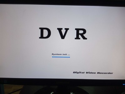

Код: Выделить всё
U-Boot 2010.06 (Aug 21 2014 - 13:53:59)
spi->chipsize:16778240
Spi(cs1): Block:64KB Chip:16385KB Name:"W25Q128B"
In: serial
Out: serial
Err: serial
(Re)start USB search...
USB: scanning bus for devices... 1 USB Device(s) found
scanning bus for storage devices... 0 Storage Device(s) found
Hit any key to stop autoboot: 1 0
saveaddr: 82000000
do_netupdate
Hisilicon ETH net controler
MAC: **-**-**-**-**-**
Up/Down PHY not link.
sf probe 0;sf read 0x86000000 0x60000 0x20000
16385 KiB hi_sfc at 0:0 is now current device
vo 0,picwh:800 600, addr=8ff00000, xywh:0 0 800 600
vo 2,picwh:800 600, addr=8ff096a0, xywh:0 0 720 576
setenv jpeg_addr 0x86000004
setenv jpeg_size 0x9ffa
setenv vobuf 0x8ff00000
jpeg decoding ...
<<addr=0x86000004, size=0x9ffa, vobuf=0x8ff00000>>
mmu_enable
<<imgwidth=800, imgheight=600, linebytes=1600>>
decode success!!!!
decode jpeg!
dev 0 opened!
## Booting kernel from Legacy Image at 81000000 ...
Image Name: Linux-3.0.8
Data Size: 3273256 Bytes = 3.1 MiB
Load Address: 80008000
Entry Point: 80008000
## Loading init Ramdisk from Legacy Image at 82000000 ...
Image Name: RAM disk
Image Type: ARM Linux RAMDisk Image (uncompressed)
Data Size: 10150065 Bytes = 9.7 MiB
Load Address: 00000000
Entry Point: 00000000
Loading Kernel Image ... OK
OK
Starting kernel ...
Linux version 3.0.8 (qy@bob-lfx) (gcc version 4.4.1 (Hisilicon_v100(gcc4.4-290+uclibc_0.9.32.1+eabi+linuxpthread)) ) #22 Tue Apr 29 17:15:31 CST 2014
CPU: ARMv7 Processor [414fc091] revision 1 (ARMv7), cr=10c53c7f
CPU: VIPT nonaliasing data cache, VIPT aliasing instruction cache
Machine: hi3520d
Built 1 zonelists in Zone order, mobility grouping on. Total pages: 25146
Kernel command line: mem=99M console=ttyAMA0,115200 root=0100 rootfstype=ext2 mtdparts=hi_sfc:1M(boot),4M(kernel),10M(rootfs),1M(config) logo_addr=8FF00000 logo_w=800
PID hash table entries: 512 (order: -1, 2048 bytes)
Dentry cache hash table entries: 16384 (order: 4, 65536 bytes)
Inode-cache hash table entries: 8192 (order: 3, 32768 bytes)
Memory: 99MB = 99MB total
Memory: 84080k/84080k available, 17296k reserved, 0K highmem
Virtual kernel memory layout:
DMA : 0xffc00000 - 0xffe00000 ( 2 MB)
vmalloc : 0xc6800000 - 0xfe000000 ( 888 MB)
lowmem : 0xc0000000 - 0xc6300000 ( 99 MB)
.init : 0xc0008000 - 0xc002c000 ( 144 kB)
.text : 0xc002c000 - 0xc05c9000 (5748 kB)
.data : 0xc05ca000 - 0xc05ed8a0 ( 143 kB)
.bss : 0xc05ed8c4 - 0xc0648568 ( 364 kB)
NR_IRQS:128 nr_irqs:128 128
sched_clock: 32 bits at 82MHz, resolution 12ns, wraps every 52060ms
Calibrating delay loop... 1318.91 BogoMIPS (lpj=6594560)
update_logo 9
uart:0: ttyAMA0 at MMIO 0x20080000 (irq = 40) is a PL011 rev2
console [ttyAMA0] enabled
uart:1: ttyAMA1 at MMIO 0x20090000 (irq = 41) is a PL011 rev2
uart:2: ttyAMA2 at MMIO 0x200a0000 (irq = 42) is a PL011 rev2
bio: create slab <bio-0> at 0
SCSI subsystem initialized
TCP established hash table entries: 4096 (order: 3, 32768 bytes)
TCP bind hash table entries: 4096 (order: 2, 16384 bytes)
TCP: Hash tables configured (established 4096 bind 4096)
TCP reno registered
Trying to unpack rootfs image as initramfs...
update_logo 10
update_logo 11
rootfs image is not initramfs (no cpio magic); looks like an initrd
Freeing initrd memory: 9912K
L2cache cache controller enabled
VFS: Disk quotas dquot_6.5.2
Dquot-cache hash table entries: 1024 (order 0, 4096 bytes)
squashfs: version 4.0 (2009/01/31) Phillip Lougher
JFFS2 version 2.2. (NAND) © 2001-2006 Red Hat, Inc.
fuse init (API version 7.16)
SGI XFS with security attributes, large block/inode numbers, no debug enabled
msgmni has been set to 183
io scheduler noop registered
io scheduler cfq registered
brd: module loaded
loop: module loaded
ahci: SSS flag set, parallel bus scan disabled
ahci ahci.0: AHCI 0001.0200 32 slots 2 ports 3 Gbps 0x3 impl platform mode
ahci ahci.0: flags: ncq sntf stag pm led clo only pmp pio slum part ccc sxs boh
scsi0 : ahci_platform
scsi1 : ahci_platform
ata1: SATA max UDMA/133 mmio [mem 0x10080000-0x1008ffff] port 0x100 irq 52
ata2: SATA max UDMA/133 mmio [mem 0x10080000-0x1008ffff] port 0x180 irq 52
Spi id table Version 1.22
Spi(cs1):
Block:64KB
Chip:16MB
spi size: 0x16777216
chip num: 1
4 cmdlinepart partitions found on MTD device hi_sfc
Creating 4 MTD partitions on "hi_sfc":
0x000000100000-0x000000500000 : "kernel"
0x000000500000-0x000000f00000 : "rootfs"
0x000000f00000-0x000001000000 : "config"
Fixed MDIO Bus: probed
ata1: SATA link down (SStatus 0 SControl 300)
himii: probed
ata2: SATA link down (SStatus 0 SControl 300)
Invalid HW-MAC Address: 00:00:00:00:00:00
Set Random MAC address: 8A:D5:2C:27:26:8E
PPP generic driver version 2.4.2
PPP Deflate Compression module registered
PPP BSD Compression module registered
PPP MPPE Compression module registered
NET: Registered protocol family 24
usbmon: debugfs is not available
hiusb-ehci hiusb-ehci.0: irq 53, io mem 0x100b0000
hub 1-0:1.0: USB hub found
hub 1-0:1.0: 2 ports detected
hiusb-ohci hiusb-ohci.0: irq 54, io mem 0x100a0000
hub 2-0:1.0: USB hub found
hub 2-0:1.0: 2 ports detected
usbcore: registered new interface driver ums-alauda
usbcore: registered new interface driver ums-datafab
usbcore: registered new interface driver ums-freecom
usbcore: registered new interface driver ums-isd200
usbcore: registered new interface driver ums-jumpshot
usbcore: registered new interface driver ums-sddr09
usbcore: registered new interface driver ums-sddr55
usbcore: registered new interface driver mdc800
mdc800: v0.7.5 (30/10/2000):USB Driver for Mustek MDC800 Digital Camera
usbcore: registered new interface driver usbserial
USB Serial support registered for generic
usbcore: registered new interface driver usbserial_generic
usbserial: USB Serial Driver core
USB Serial support registered for GSM modem (1-port)
usbcore: registered new interface driver option
option: v0.7.2:USB Driver for GSM modems
usbhid: USB HID core driver
TCP cubic registered
IPv6 over IPv4 tunneling driver
RAMDISK: gzip image found at block 0
update_logo 12
update_logo 13
VFS: Mounted root (ext2 filesystem) on device 1:0.
Freeing init memory: 144K
EXT2-fs (ram0): error: ext2_check_page: bad entry in directory #1754: : directory entry across blocks - offset=0, inode=449024, rec_len=3072, name_len=0
Kernel panic - not syncing: No init found. Try passing init= option to kernel. See Linux Documentation/init.txt for guidance.
Backtrace:
[<c0036d50>] (dump_backtrace+0x0/0x110) from [<c04c1390>] (dump_stack+0x18/0x1c)
r6:c0047c84 r5:c05edc90 r4:c05edc90 r3:60000013
[<c04c1378>] (dump_stack+0x0/0x1c) from [<c04c1408>] (panic+0x74/0x188)
[<c04c1394>] (panic+0x0/0x188) from [<c002c594>] (init_post+0xa8/0xd8)
r3:c5c2df18 r2:c2007300 r1:c06890e0 r0:c05623a4
r7:00000013
[<c002c4ec>] (init_post+0x0/0xd8) from [<c0008494>] (kernel_init+0x124/0x12c)
r4:c0025d2c r3:00000028
[<c0008370>] (kernel_init+0x0/0x12c) from [<c0047c84>] (do_exit+0x0/0x6d4)
r5:c0008370 r4:00000000
